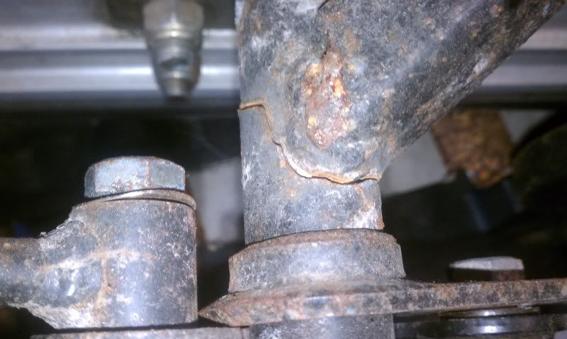

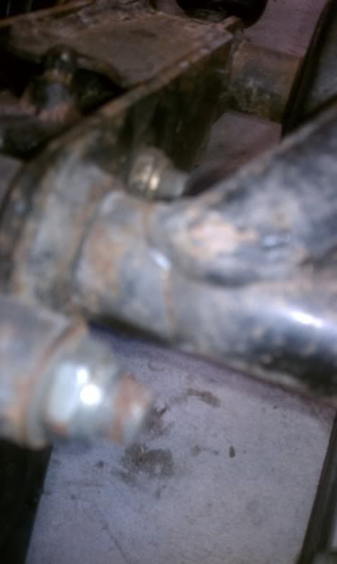

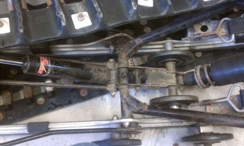

After removing all suspention and track today i noticed 2 cracks in the torque arm, can i have these welded or will i need to order a new one? The cracks seem to be at the same place on both sides all the way around the shaft.
427 Posts
I would reweld them. I'm a good welder. Proper orientation is important. I wouldn't think of welding them without sliding a bar through the assembly. One made of steel would nice. Aluminum melts at a lower temperature.
hurry up winter
129 Posts
Ya you can weld them I broke one right off both sides on and indy 500 and welded it back together it never broke or cracked again
