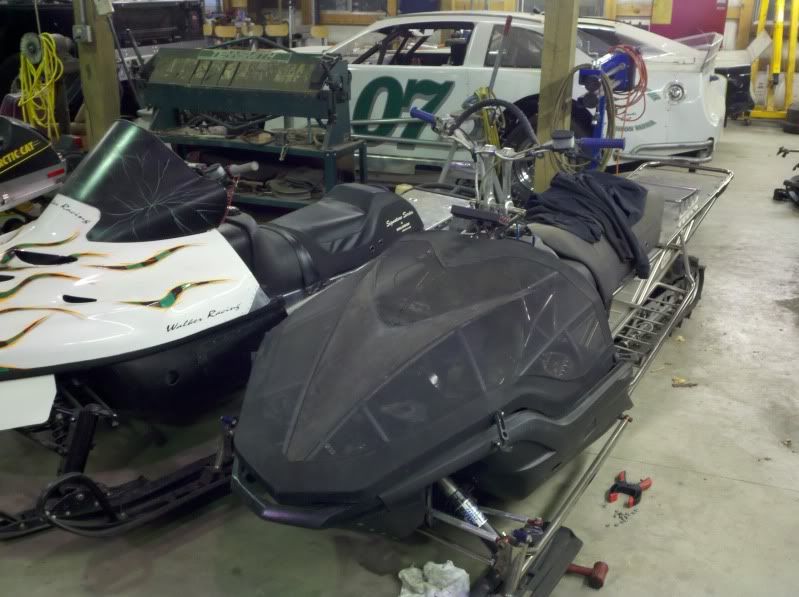

I managed to get a few :)
Titanium Chassis
Sled collection with one hiddin (titanium chassis) in the left top corner and the 400HP Apex pictured below
This Apex was built by these guys and can be seen in video # 4

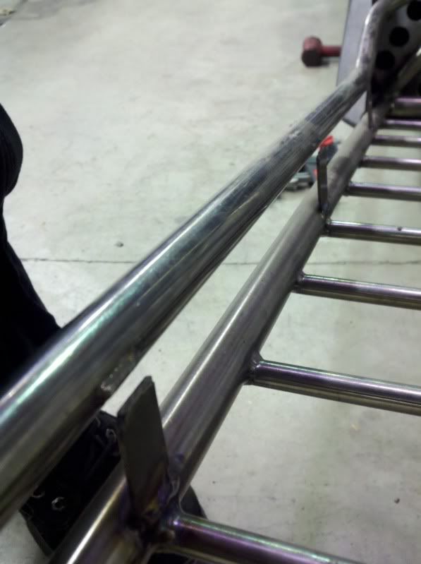

And for the record, these are whats broke on the titanium chassis
See less See more
