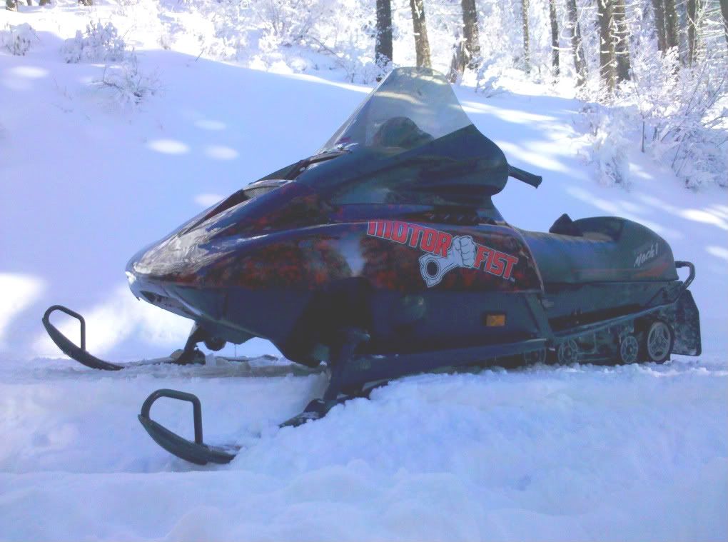

Hey guys first post here... I just got into sledding this year and I was given a 91 Formula Mach 1 617. I got the beast running like a top, but I would like to upgrade the skis to some wider newer plastic skis. are there other years of Ski doos that have interchangable skis?? Do the newer Formula models skis bolt on? I like this old sled to ride the trails on so I would like to get something used to keep costs down. Any help is appreciated! Thanks
Here is a picture of the sled after I repaired the damaged hood and got it running last weekend...

sharp lookin mach. welcome to the forum
thanks alot! I think it turned out real nice!
smallengineguy Where did you get the graphics for it?
I custom painted the hood myself, and the Motorfist sticker I got locally at a snowmobiling/motorcycle shop...For Free!!

Yes my grandpa gave it to me, said if you can get it running ride the hell out of it.
When I got it was a far cry from looking like anything you would want. So I took it to work and worked on it during my free time, tore apart the carbs, cleaned those, put in a new primer and fuel lines, removed the fuel tank flushed it 3 times, replaced the fuel lines inside the tank w/ new filters, fixed the fuel sending unit, cleaned the exhaust valves (they were caked with buildup) replaced the bulbs, repainted the body of the sled....
The hood when I got it had 19 major cracks or breaks, fiberglassed and smoothed it out and gave it a custom paint job..over all it took me about 25-30 hrs to get the sled where it sits now, but I did it all during my down time at work and a few hours on the week ends.... it just needed some TLC... it runs amazing, I just want to get some plastic skis for handling, stiffen the rear suspension a little bit and adjust the headlight and it should be a good sled if I maintain it properly.
Im pretty proud of the way it turned out, its my first sled! My uncle and cousins were amazed how it turned out from the last time the saw it when my grandpa totaled it!

do u have any before pics
only a few crappy cell phone pics.... the one of the hood does not even begin to show all the damage, the back side of the hood where the vents are were broke in 3 pcs on each side..bunch of rivets and metalstraps were holding it all together.
