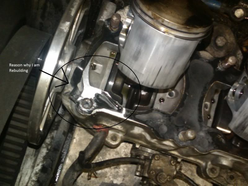

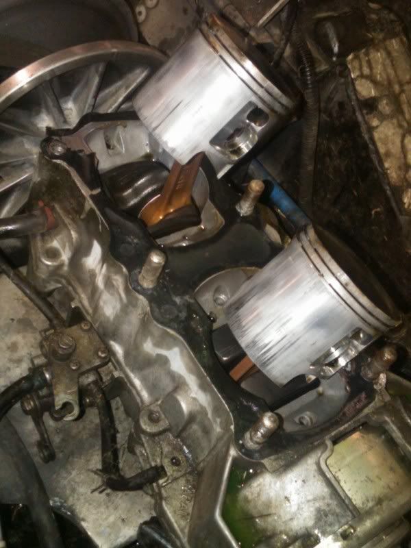

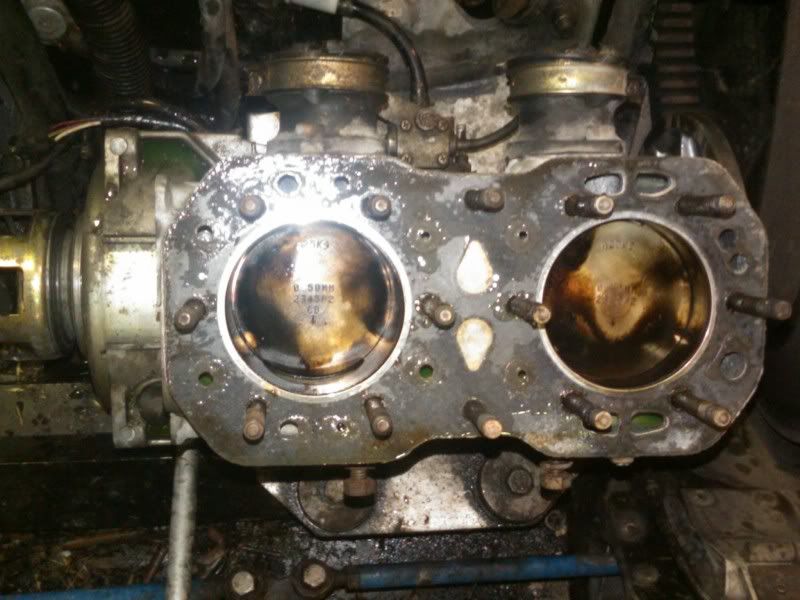

I am rebuilding my fuji 500 out of my 1990 polaris indy 500 because it blew the gasket between the crankcase and the cylinders...( see in photo ) when i took it apart i noticed some wear on the pistons and wanted some input on if i sure just change gasket and leave everything or changes rings/ pistons etc... the pistons say .50 mm on them? does that mean its been bored over 50mm over . Well any input will help .. tell me what you think of the pistons

yes thats bored that much. mine is .40 over and mine say that on mine. i was told .40 over is the most you wana go safely i that motor. how do the cylinder walls look? and are the pistons scored or just glazed? if they need to be replaced and even bored more you'll need to get new jugs or re-sleeved. and those for sure are not stock pistons. they look like my .40 over lite ones i just put in mine.
Premium Member
34,103 Posts
Normal scuffing and wash on top of the pistons.
How long ago was the last rebuild done?
If not so long ago, just put new gaskets on and go, otherwise, just new rings too.

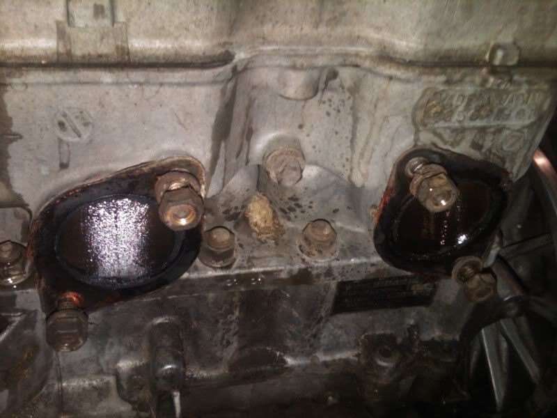

my uncle i bought it off had a friend screw with it all summer and his friend said he rebuilt it then... and no one used it till i got it three weeks ago ... i dont remember seeing if that gasket was pushed out or not .. or if it happened after.. the stud by where the gasket got pushed out came out with the nut and seems to be a little stripped so maybe it wasnt tightened enough? so i should just regasket and go?
i guess try the old stud and if it doesnt grip put a coarse bolt and tighted it with that?

is the bolt stripped or is the hole stripped?

ok here is the my solution to the stripped hole .. the threads only go done about 3/4 of an inch and the hole goes down and inch or so so i rethreaded the hole deeper and used 3/8 threaded rod and pics will tell the rest

Threaded rod repair looks ok as long as you got good threads in the block. Carb float arms need to be level and the same on both sides. Carbs need to be straight up and down in the boots- your boots are wrong. Just cut off the rubber locating tabs or grind the locating protrusion off the carb and you'll be good to go.
