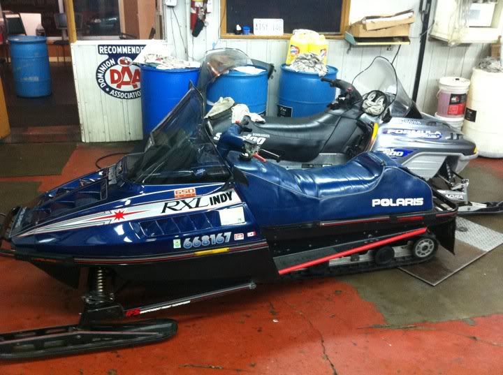

Got this mint '91 RXL SKS with 17000 miles, the motor has never been opened and has good compression, 120 psi across the 3. I believe both the primary and secondary clutches are bad even though the motor gets to 8400 rpm real fast and has tons of torque but it takes awhile for the sled to gain actual speed.
Could someone suggest a good clutch kit? Got an radar race comming up next month and I'd like to see how fast it goes.

Well, if you are just lookin for a higher RPM engagement ,spring & weights will help that & secondary adjustment.Also your chaincase gearing will help lowering it for that top speed quick ,lift off short quarter mile run that you striving for.

Not sure what Im looking for honestly. Took the RXL out today, I'll upload some vids tonight so you can hear whats going on. When I let off the gas you can hear an odd whining sound coming from the secondary, like its closing too fast. Has awesome power right till redline but just doesn't seem to have that pickup and go feeling.

You stated that it has 17000 miles ,I'm assuming that it's actually 1700.0 miles,correct? With that sled being in that condition 120 PSI in all three cyl. & engine never opened ,it's very unlikely it has 17000 miles.
Anyway ,if your belt isn't top notch then you might have a issue of bogging in the first 100ft !? The belt should be about 1/16 to 1/8th of a inch above the secondary sheave .The wining noise that your hearing is common when your braking ,(like BC Dan mentioned).
I would try changing to a new belt first then let's see how it's performing,then take it from there.

Its 17K miles. All service records indicate this to be true, went to the dealer which is about .5 kms from the gentlemans home to verify. The belt does sit low in the secondary, will order new one on Monday.
