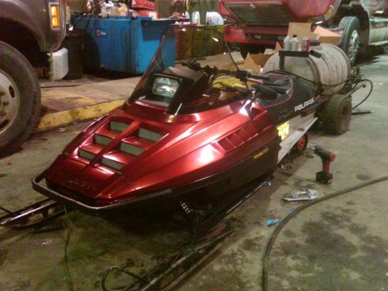

i have a 1990 polaris indy 500 ... how the heck can i get more height from the front end ?? like 3 inches so i can clear more powder and not get hung up .... i know its an old sled and its never going to be a deep powder sled but ammuse me :)

thats 10 inch travel or just a name... could i use the 12 suspension .. or what is the problems with that?? are these both are to find? pros and cons ??
Premium Member
34,103 Posts
Actually, both are the same travel.
The 10 uses rising rate springs that get stronger as they are compressed.
The 12 uses falling rate springs that are stiffer to begin with and get softer as they are compressed.
They both also use different length shocks that are valved differently too.
