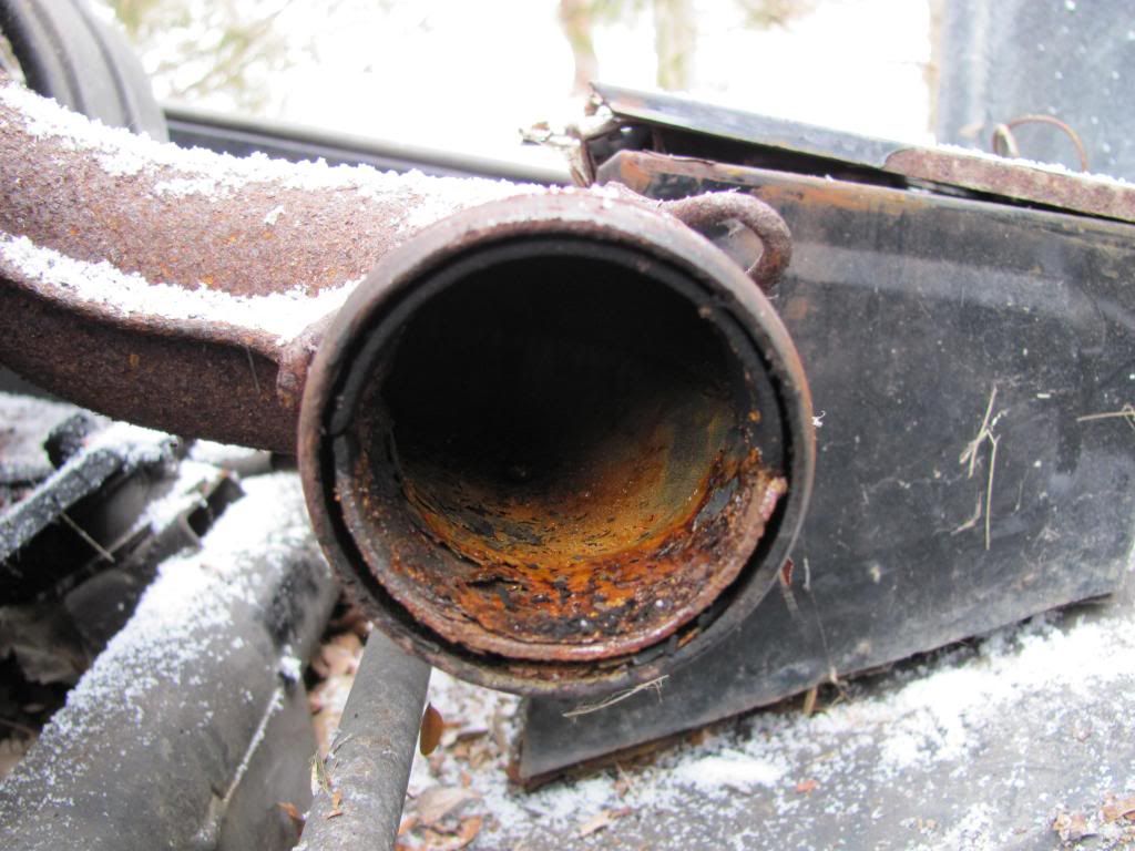

Thank you, looks like a great place/forum! I suppose I should share some more progress I have done. It was snowing out today so I didnt want to mess with the carb or airbox. But I thought I would make some room to work and remove the exhaust.
Darn locust trees, its gonna take forever to clean out all those leaves lol. Atleast now I can kind of see what im working with and I dont think its that big of a deal (as long as theres nothing causing resistance to something or getting in the way.
Then a peak inside the manifold:
and a look at the block:
Then the muffler off:
and a look inside where it connects to the manifold:
I used an air compressor and blew air through it and not much seemed to come out. It seems to be in good shape.

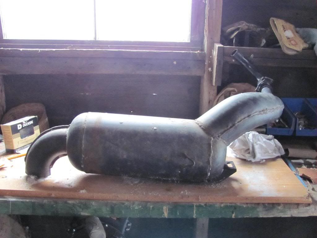

Thanks, I just got accepted to that forum now. I decided to remove the exhaust since it was easy and would give me more room.
I also used some compressed air to blast out any debris that would be in the exhaust but I dont think it would of completely removed any mouse or bee nests if there are any?
Corolla Sound is offline   Reply With Quote

Take a short length of small chain and attach it to a short cross bar.
Hang the chain inside the pipe and shake it around, that will loosen anything that is still in there.
