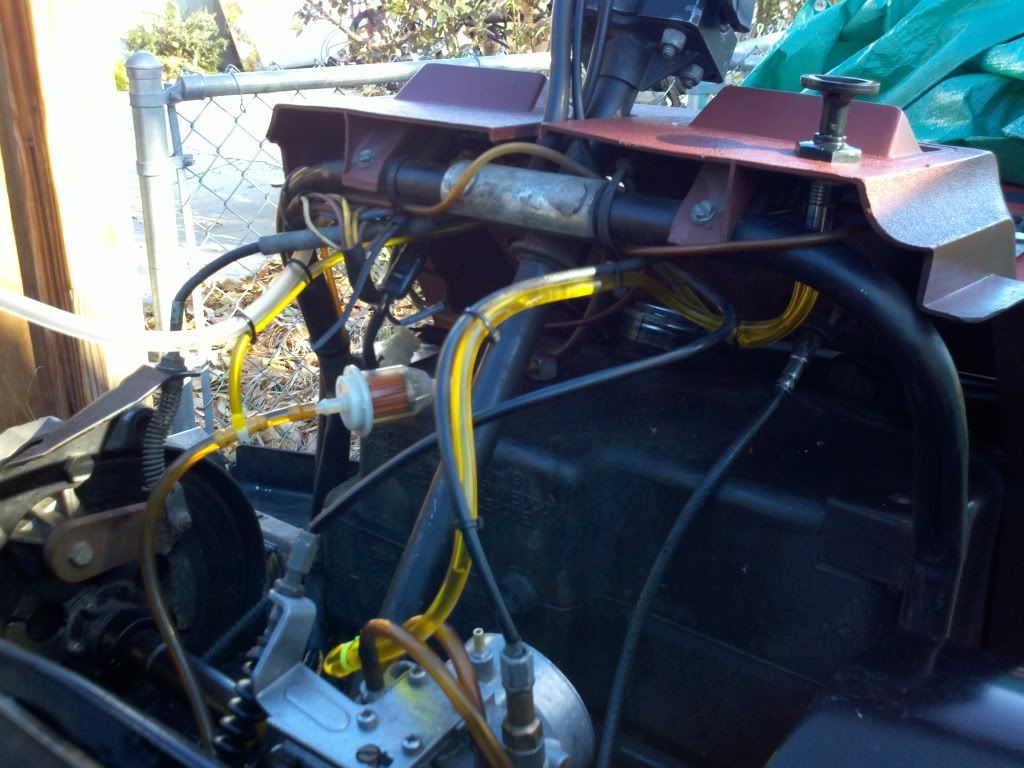

Primer????
I have a 73 Panther 440 that I'm putting back together. It was dismantled for parts due to a blown engine and I got an engine and put it back together.
I have quesion about the primer. I now the primer pictured in this post but it's used and I don't have the directions. Am I able to just put it inline? If so, do I put it on the feed or return? Due to the size of the nipples on the primer, I put it on the return and it doesn't work right. I even tried swapping it around but it keeps sucking air.
I see a T-joint in the picture, but I don't have that. I could get one, but I just need help in figuring out how to plumb it in.
Thanks,
Jon
Originally Posted by 98yota View Post
Well I got the primer and choke switch installed! It sure is nice to pump the primer twice, give the rope one pull and the Old Cat starts after a week in the cold... Nice!
The aluminum choke handle fit perfectly and feels really solid!
The only fittings on the intake manifold are for the old injection so I decided to drill a small hole were the newer Cats with same carb have a nipple. I JB welded the nipple fitting that was supplied with the primer kit. It squirts the fuel perfectly into the throat of the carb.
jjcsnlynn is offline   Reply With Quote

I ran the ran the inlet to the primer from the feed line to the fuel pump. The staggered nipple on the primer is the intake, the straight runs to the carb. The tee can be found at any parts at any parts store. Good luck, sounds like a cool project! I'd like to build an early 70's Cat one of these days!

Ok, still confused. The lines from the tank feed are larger than the nipples on the primer. How did you get them to stay on the primer? And If I got this right, it goes from the tank feed to the primer staggered nipple, then out the straight nipple to the carb? What is the T for?

Sorry, I wasn't very clear. You need to get smaller fuel line to plum the the primer (I believe it's 1/8".) You splice the tee into the feed line going from the fuel tank to the fuel pump (I believe 1/4" line.) The tee has 1/4" ends and the middle outlet is 1/8". I made the splice after the fuel filter to make sure filtered fuel goes in the primer. I ran the 1/8" line from the tee to the straight nipple on the primer, then ran an 1/8" line from the staggered nipple on the primer to small fitting on the carb. Hope that cleared it up a little for you. If not I can try to get some installation instructions in PDF for you. Let me know how it goes, maybe a picture of the install.

I'm sorry! I had the lines mixed on the primer! Oops the inlet to the primer is the straight nipple, staggered is the outlet.
http://www.vintagesleds.com/library/...l%20System.pdf
The picture on pages 16 and 17 of this link shows how the primer should be plummed.
