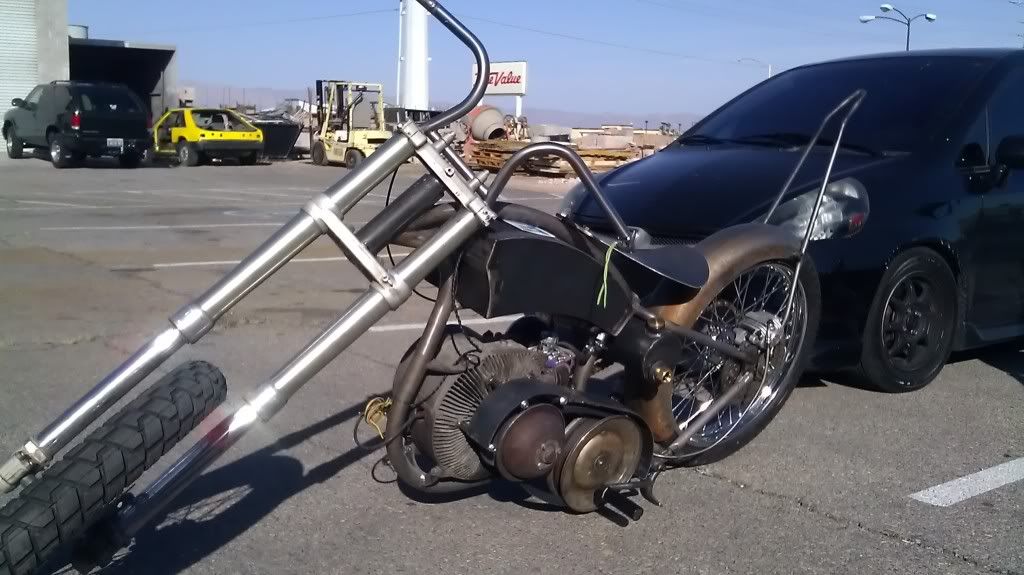

Looks like you still need to remove a shim in the secondary to get the belt up more to the outer edge of the sheaves.

Thanks RJ, the photos are actually 2 days old and since then I did move the secondary another 3/4" in like you had mentioned quite a long time ago. I'm off to fab a belt cover today and bleed the brakes, perhaps Ill take it for its maiden voyage today. I'll update with more media soon.

That's a very cool project. For sure put a cover over that belt an the clutch too. Something kinda heavy/strong those clutches can blow apart. My uncle had a similar setup on a go cart the clutch came apart an cut his shoulder bad.

thats turning out absolutely gorgeous. great job on the fab work. those forks look beefy as hell! what'd those come off of?

1/8" plate cover made today.
Thanks for mentioning, I however knew that I wouldn't get on that thing without one! I took it for it's 1st voyage today. I got it up to about 50mph and it really needs to have the carb tuned now.
Those forks are from a 99 Honda CR125 dirtbike.
~Alex

How does she handle with that crazy rake?
I love the look of the bike. It'd be real neat to keep it that bare metal color after paint I think. Especially if you could get the forks that bronzed look. Gives it a real old school custom look.

Belt cover looks good.
I do recommend that you add more to it to cover from the sides better.

It handles just like any 40 degree rake bike:a little floppy. I need to modify/increase the fork stops. Once it is rolling it feels okay.
You think clear for this thing?

Yeah, clear coat it as is.
