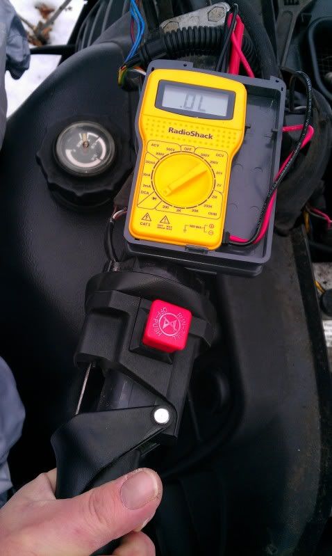

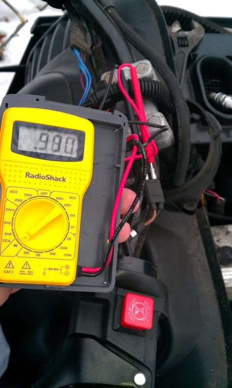

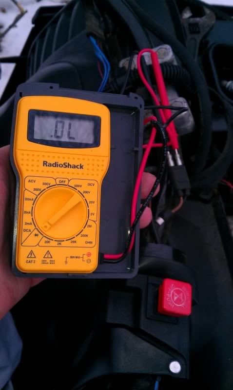

Old 01-11-2013, 11:46 AM   #16 (permalink)
Camlee98's Avatar
Join Date: Nov 2012
Location: NH
Posts: 34
Ok I got the meter out and did the tests. I think I did them right but I took pics just to be sure.
I also did a compression test and got 120 on one side and 115 on the other so I guess that's not too bad.
Here are the photos.
Here I have the kill switch on button down.
Here is Kill switch off button up.
Here is WOT Kill off
Here is Idle kill off

Posts: 843
Those are numbers that would fit with Polaris' guidance. The next step in their eyes is to replace the CDI.
