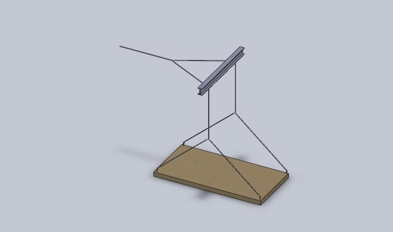

the plywood platform should work, just have a good 2x4 frame below it, something basic....as for the cable lift, I think if you have each side come to a center point on their side (4 cables, 2 lift points). Then run them through a pulley where ever at the ceiling, then tie them together and run it to a good winch.
Then you never have a height restriction because of the cables center section. I think that it would be more stable with the two mounting points too..

Somethin I drew up, What does the ceiling look like where you are going to install the lift? Depending on the structure, you might be able to hang the cables from the ceiling rather than an I beam.

that looks nice but what ever your lifting must be perfectly balanced.if a beam and trolly with a hoist and straps are used the load is stable.
I really like the looks of this for summer storage in my garage. I have a beam going to the middle of a garage that I could attach to. Has anyone ever done something like this?
